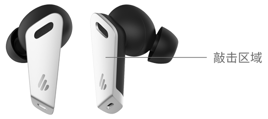

1. 产品说明及配件
配件:充电盒*1、耳套*3对、收纳袋*1,充电线*1
本产品配有不同型号耳帽,不同的使用者请选用适合的耳帽佩戴。

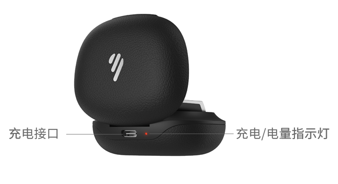

接入标配的Type-C线为充电盒充电;
输入:5V⎓60mA(耳机)
5V⎓1A(充电盒)
充电盒电量显示
充电盒开/关盖时,将自动读取电量并指示;
指示灯闪烁3次=电量充足
指示灯闪烁2次=中等电量
指示灯闪烁1次=电量不足

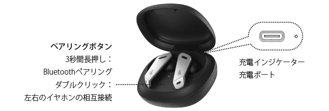

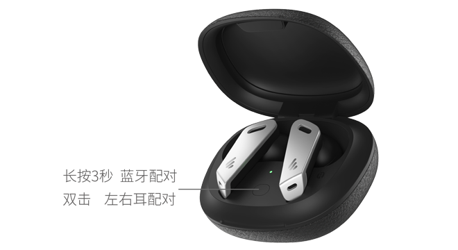

3. 蓝牙连接
蓝牙连接
1. 耳机与手机连接

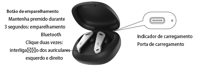

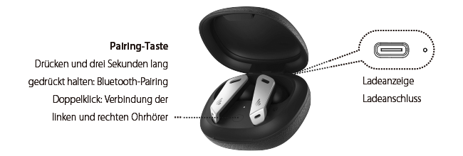

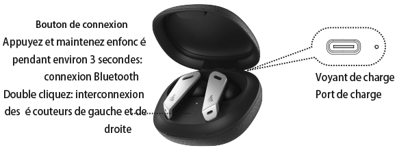

1.打开充电盒,长按充电盒按键3秒,白绿指示灯交替快闪;
2.在手机上搜索此型号名并连接,成功后取出耳机使用;
2. 左右耳互连/恢复出厂设置
打开充电盒,双击充电盒按键后,等待连接,直至白绿灯交替闪烁时,耳机已恢复出厂设置并左右互连成功;

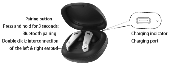

Bluetooth connection
Interconnection of the left & right earbuds/restore to factory settings

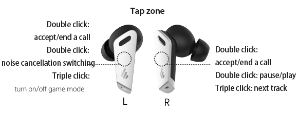

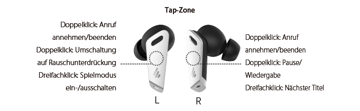

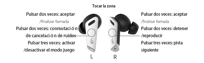

2. Operation description

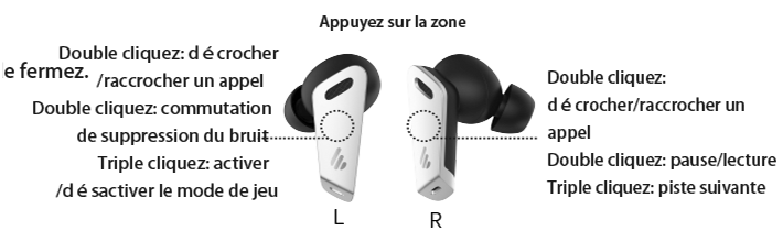

Note:

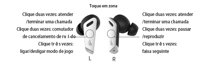

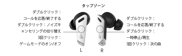

After the earbuds are powered on and worn into the ears, the noise cancellation mode will be automatically enabled.
When playing music: removing the earbud can pause playing and wearing again can resume playing.
For noise cancellation switching: there are noise cancellation mode (when both earbuds are used), ambient sound mode, and normal mode.
To enable noise cancellation mode when using one earbud only, you can close the automatic in-ear detection via the APP.
