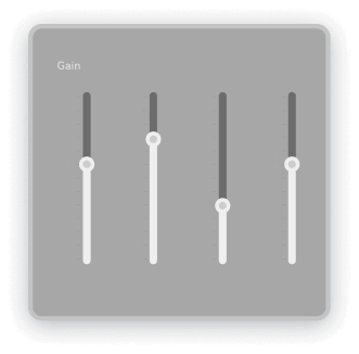

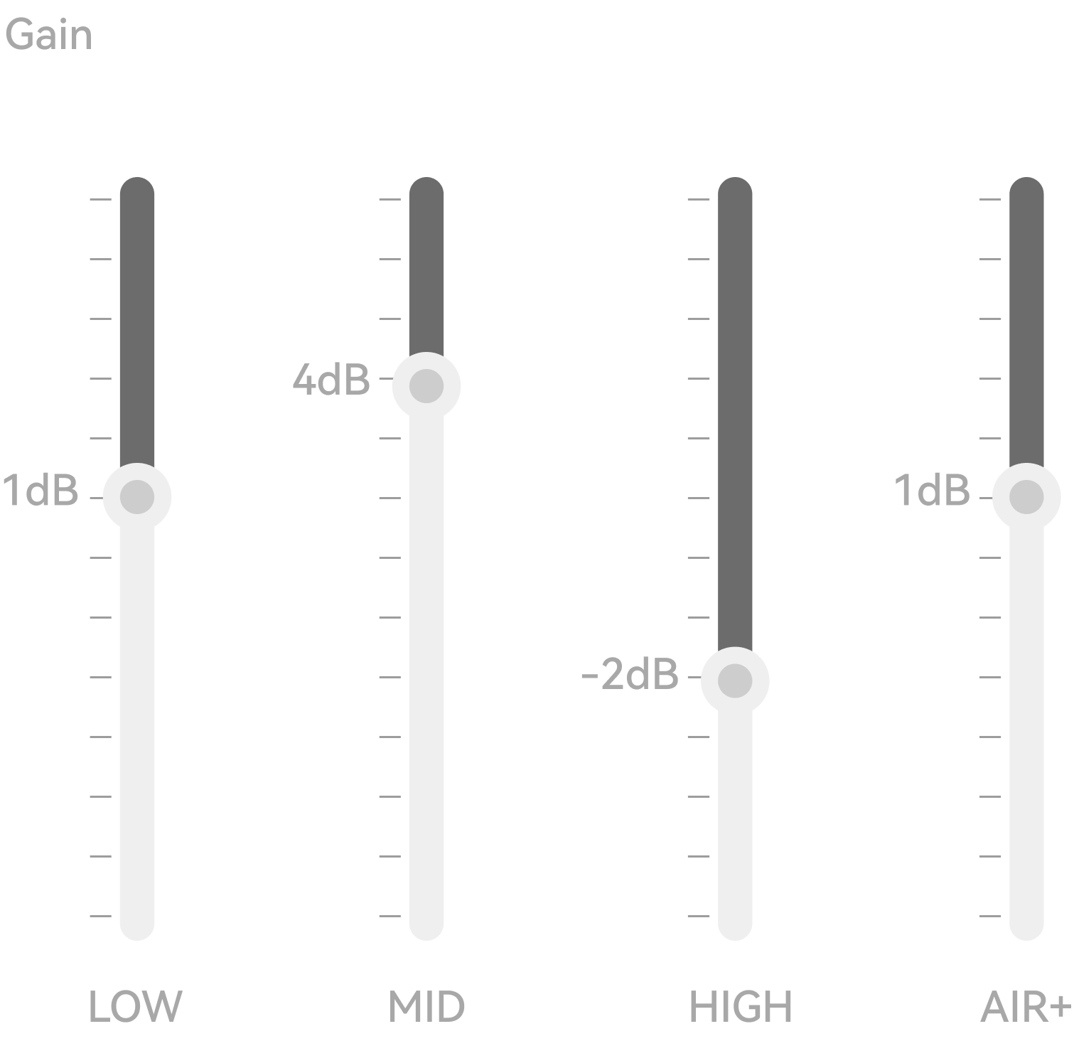

      Gain: Gain controls how much of the selected frequency is added or removed. Turning the gain up increases the amount of the frequency to add, and turning the gain down removes more of that frequency.You can adjust the gain for different frequency ranges to boost or cut certain frequencies to your liking.

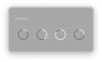

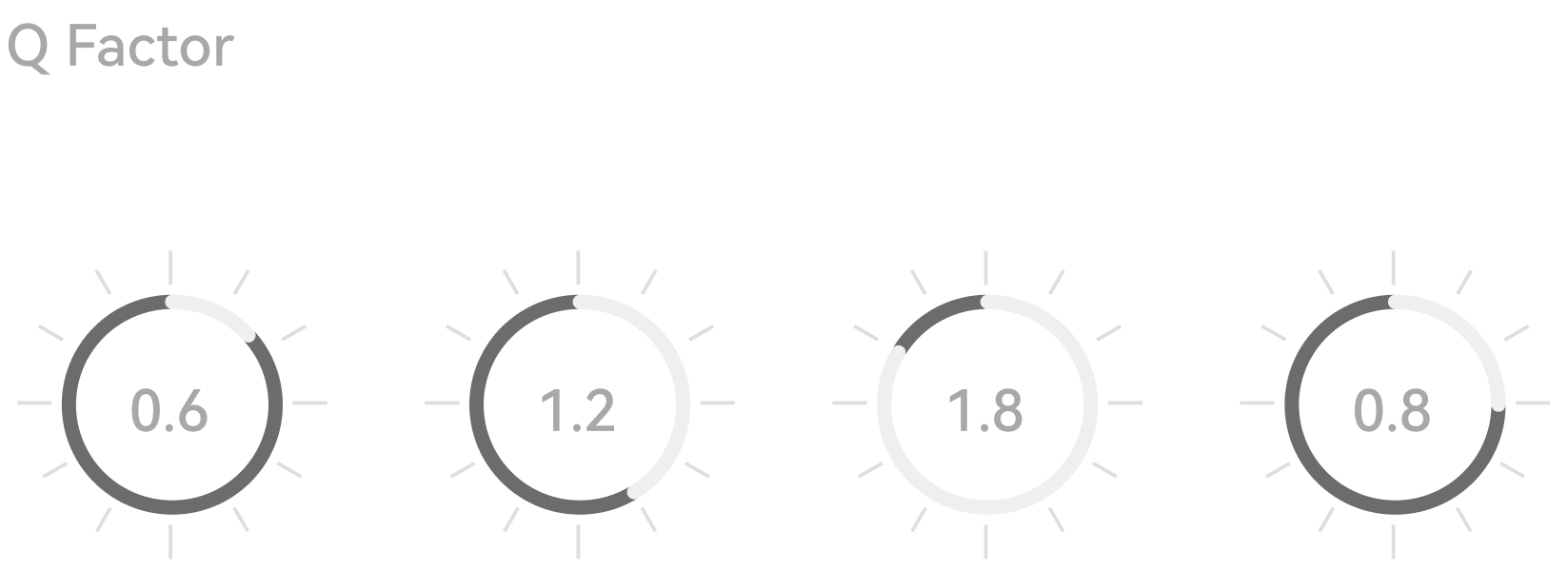

      Q factor: This setting adjusts the width of the frequency range being affected by the EQ. The Q factor is simply the ratio of the frequency width to the central frequency. A high Q factor narrows the range affected by the EQ, while a low Q factor widens it. Adjusting the Q factor allows you to target specific frequency ranges more precisely.

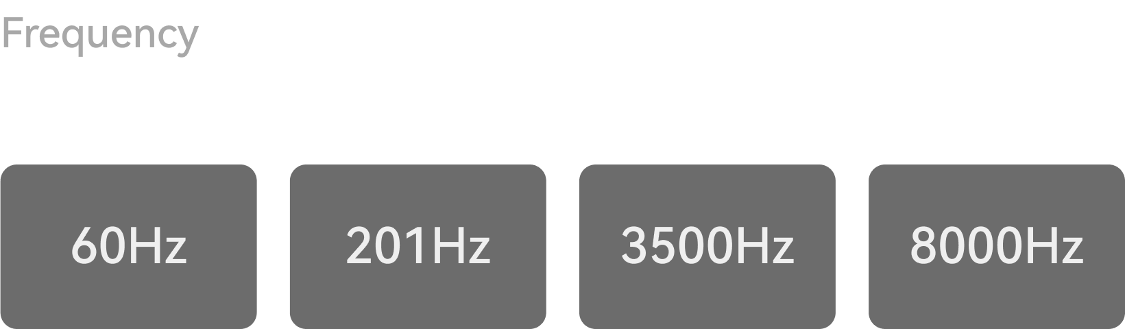

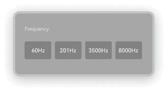

      Frequency: This setting adjusts the specific frequency range being affected by the EQ. You can adjust the frequency settings to target specific frequency ranges that you want to boost or cut.

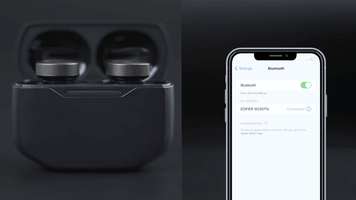

      2.Connect to your Edifier device: Pair your mobile device with your Edifier Bluetooth headphones or speaker using the Edifier Connect app.
